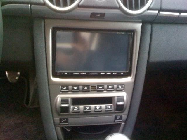

This is another option if you are open to replacing the radio. You will get full control of the iPod at full speed from the touchscreen display as well as AM/FM, and CD/DVD capabilities. You will also upgrade to a Garmin based Navigation system and have the ability to add Bluetooth, Satalitte, HD, you name it.
Attachment 1693
