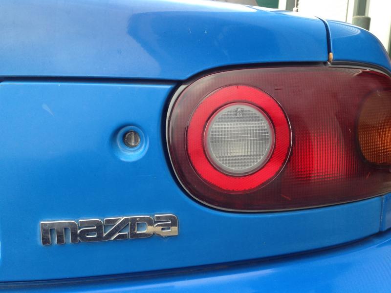

Here are some 50/50s of how it performed. The owner came out while I was working and was just as happy with the results as I was.
