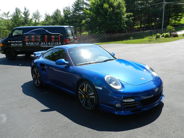

Let me first introduce myself, my name is David Purser, owner of Unique Detailing in Bristol Va. I travel across the east region. Let me introduce Porsche 911 Turbo S. This was scheduled for a full correction. The condition of the car was in very good condition with a few random scratches and minor holograms. I was able to remove all the defects and make the paint "Pop"

My camera wasnt picking up all the defects but you could see random scratches throughout
With Porsche paint being soft i was able to use Lc Black with M205 to remove the defects
There was some heavier scratches on the rear bumper, so i used Surbuf/M105 to remove

On the hood i used the Megs Microfiber system, followed by Lc Black M205
Once the car was polished i went over the car with CG Ez Cream Glaze to clean the paint and add cherry on top

The wheels had a few marks here and there so Lc Black and M205 took care of that
Then the wheels were sealed with Blackfire Wet Paint Sealant
The rest of the car was sealed with Blackfire too
After it was left to cure it was wiped off
