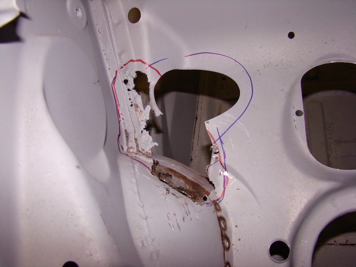

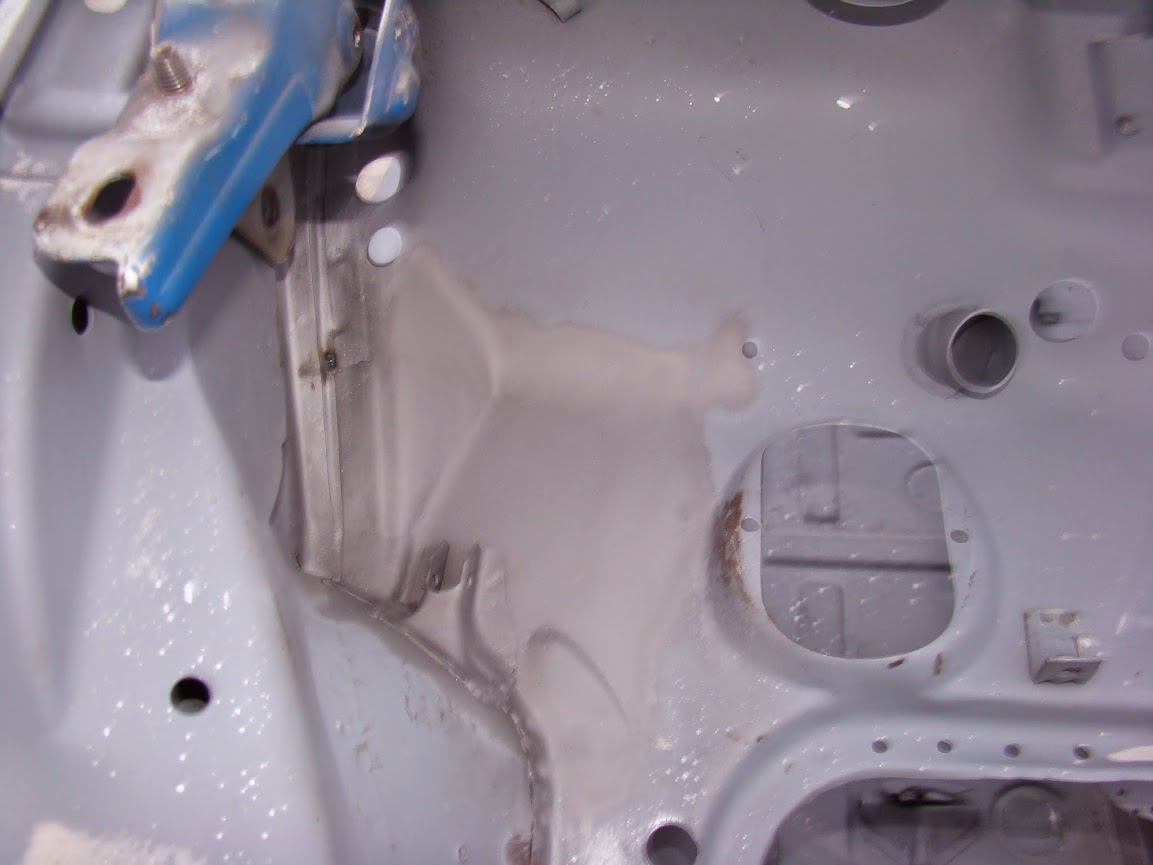

Posts: 11
The front firewall of this car had been modified over the years. The holes in the firewall were cut out prior to us receiving the body. The rust was caused by water that had worked its way down from the clogged sunroof drain on the passenger side A-pillar.
