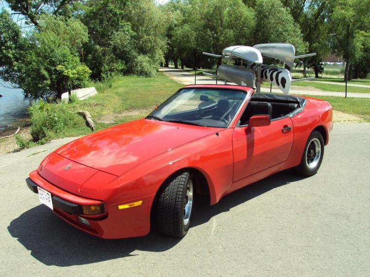

I have an '84 944. It just started stalling a couple days ago. The first time I was at a stop light and it just died. It would restart but die again within a second or two. After about 5 restarts it kept running. It ran fine for a couple days. Now today I shut it off waiting for the ferry and when I tried to restart it did the same thing and took several tried to keep running. Then it stalled a couple times while driving. I just left the clutch out to keep the engine spinning and it recovered after 5 or 10 seconds and ran fine. It also has an occasional misfire at full throttle but it is random. Where is a good place to start?
