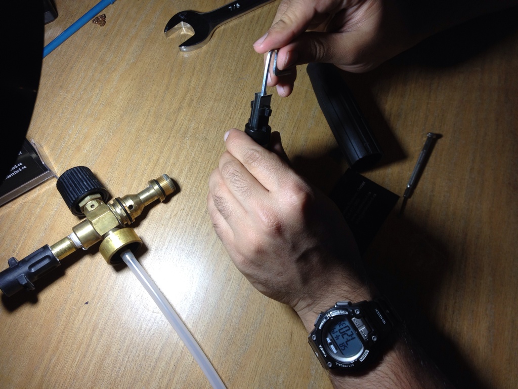

How to clean your foam cannon
By Hamza7

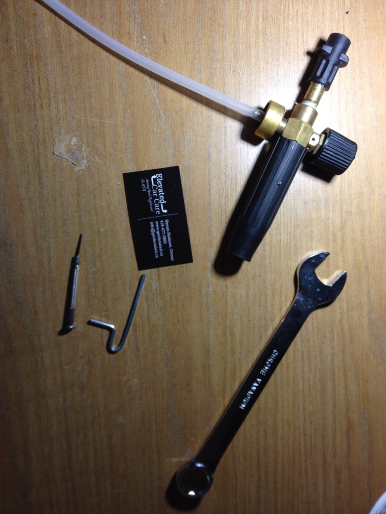

I first thought I owned a Riccardo Foam Cannon but after closer inspection it's just a MTM Hydro.
What you'll need for this

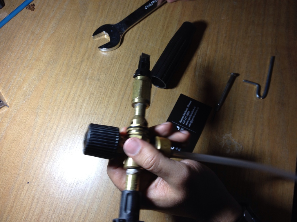

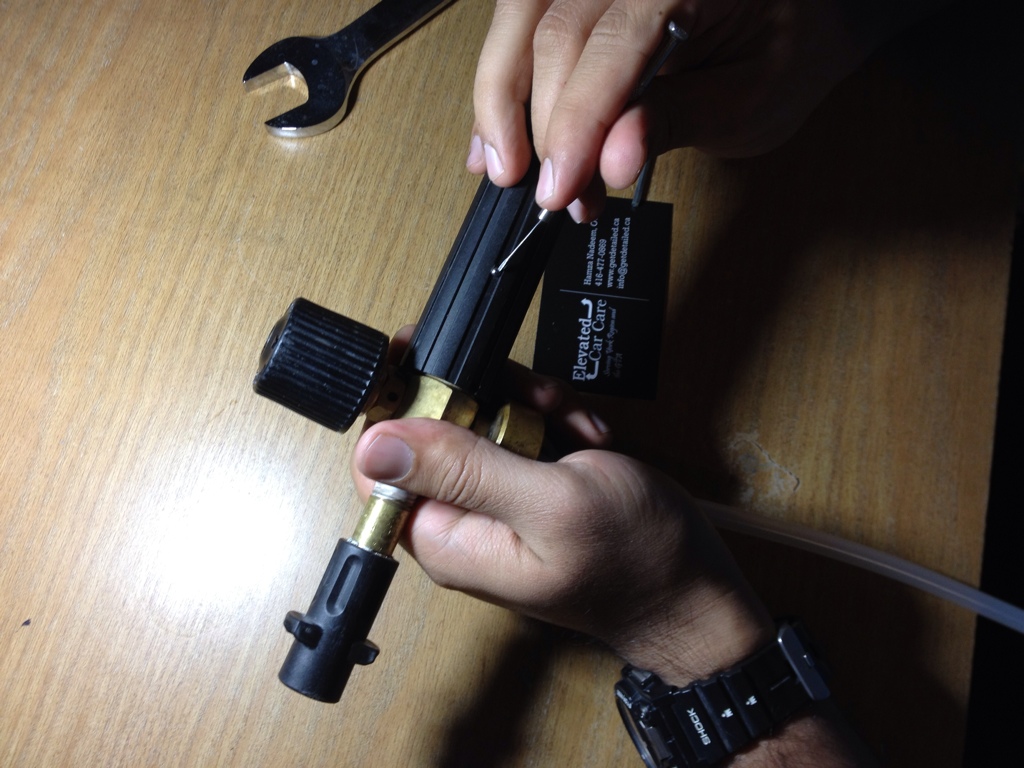

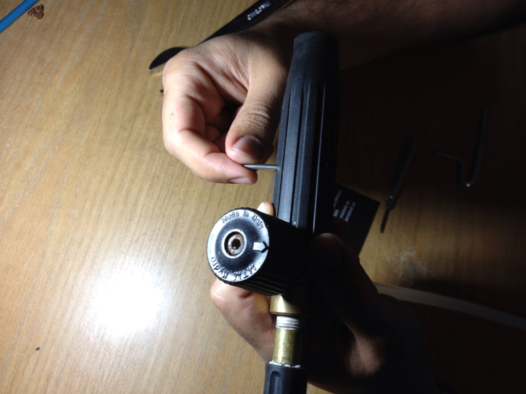

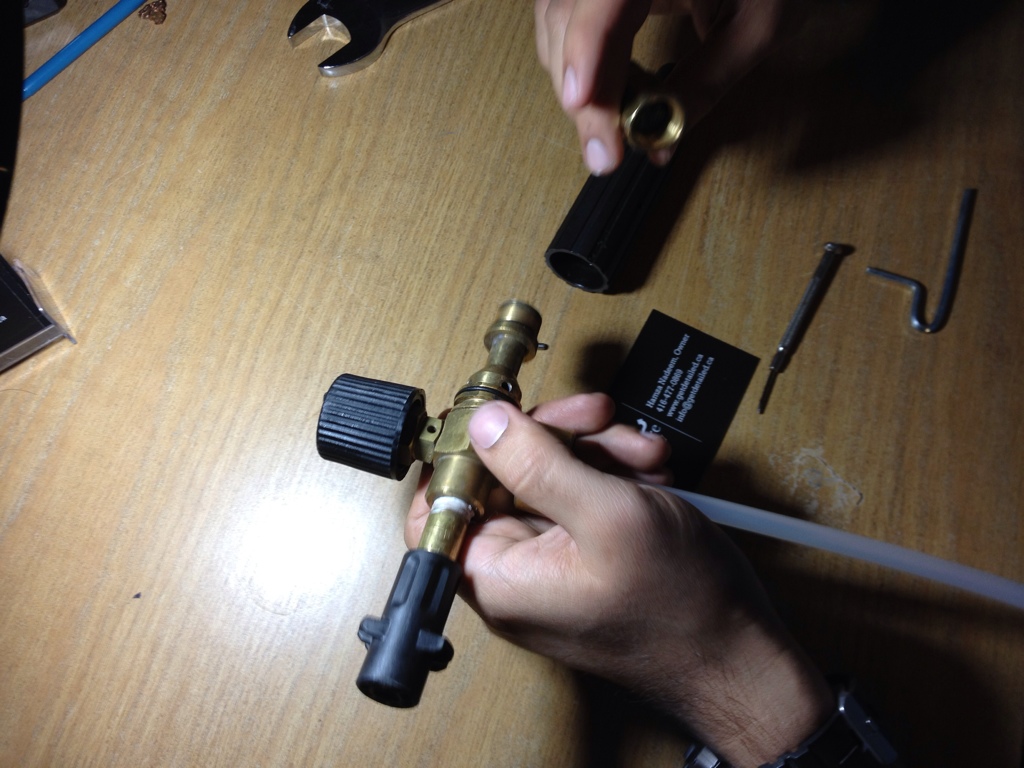

This is the first pin you need to push out with your small diameter tool

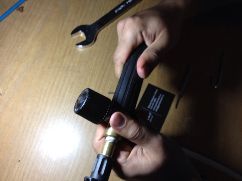

Now slowly YANK the black spray adjuster out

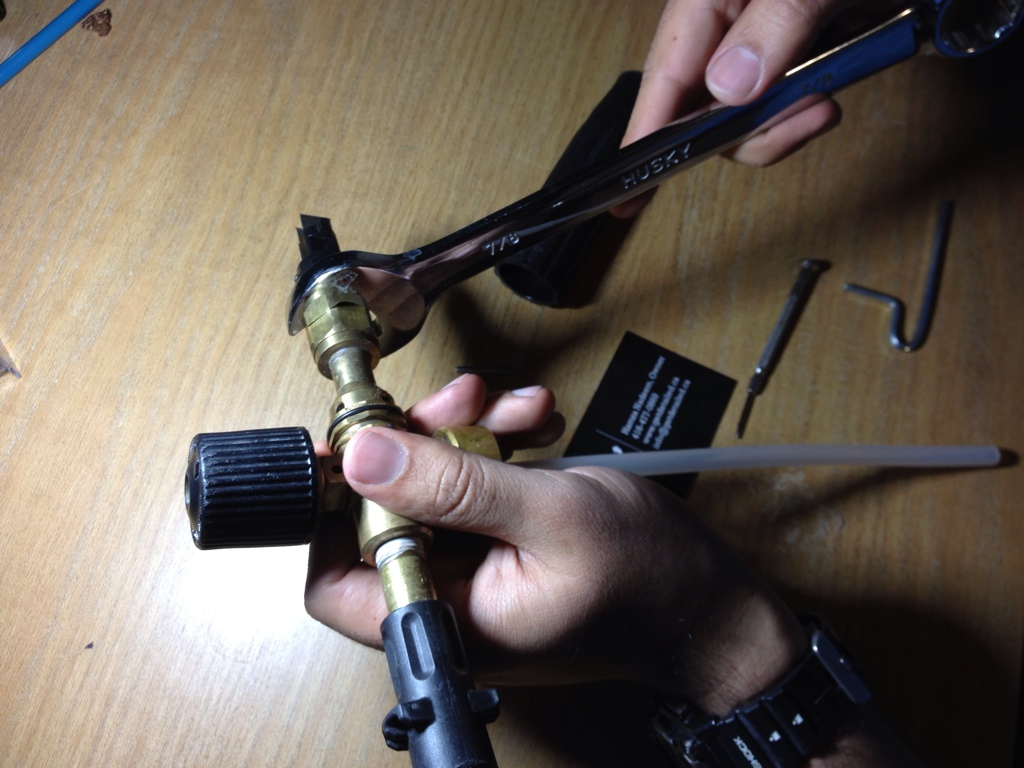

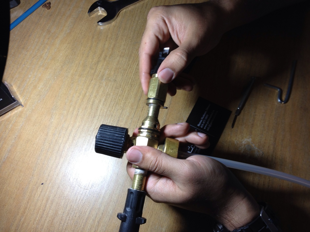

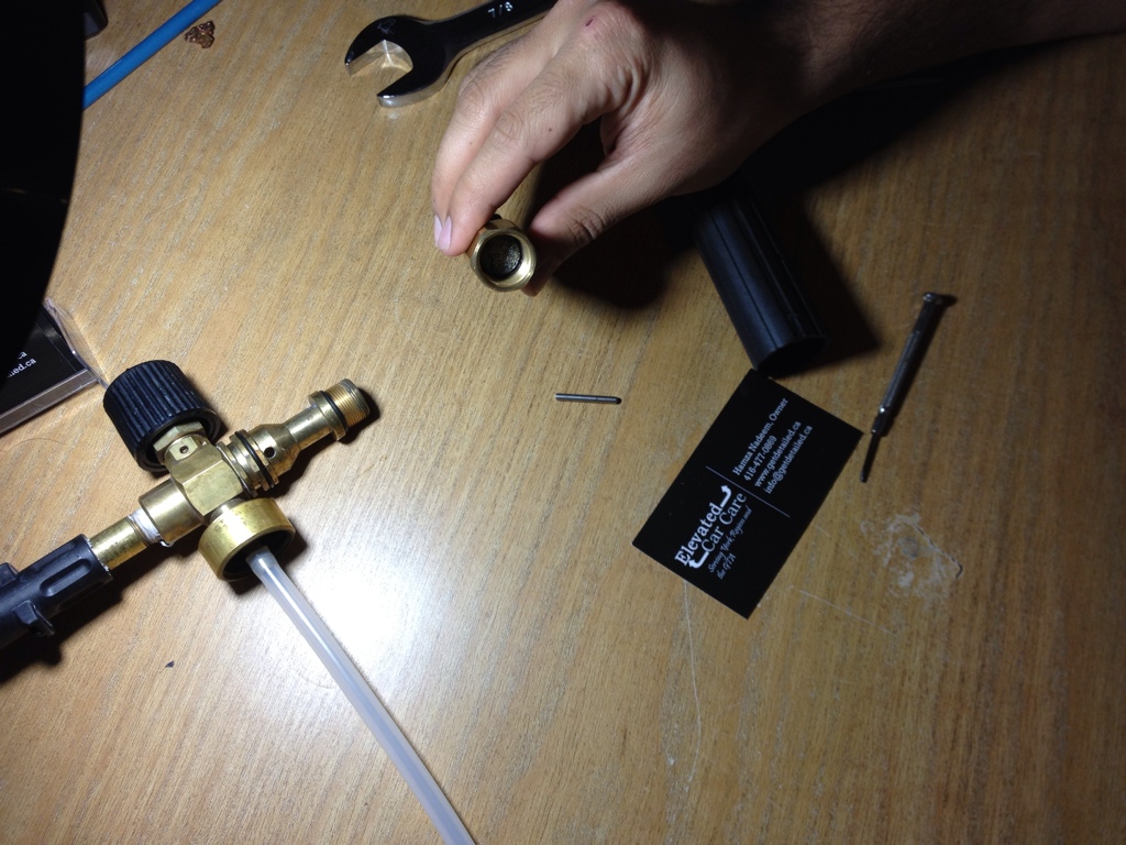

Next take your 7/8th inch spanner and grab hold of the the brass thing you see in the picture
After you release the initial tension you should be good to just loosen away by hand

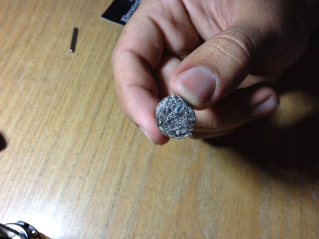

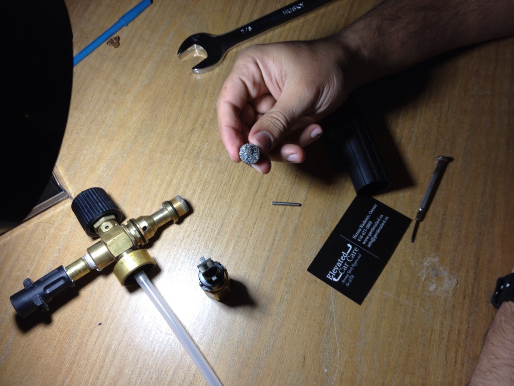

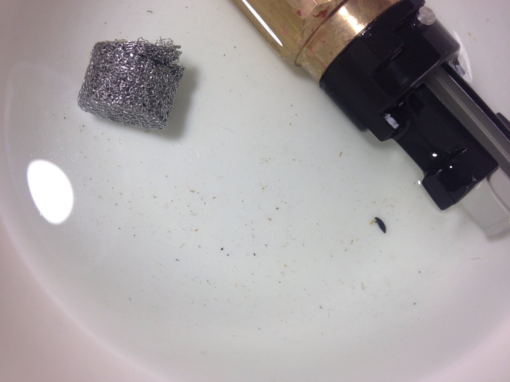

Can you see the little metal filter inside that piece
I use the end of a L key to push it out
Pop, it came out
Can you guys see that filthiness

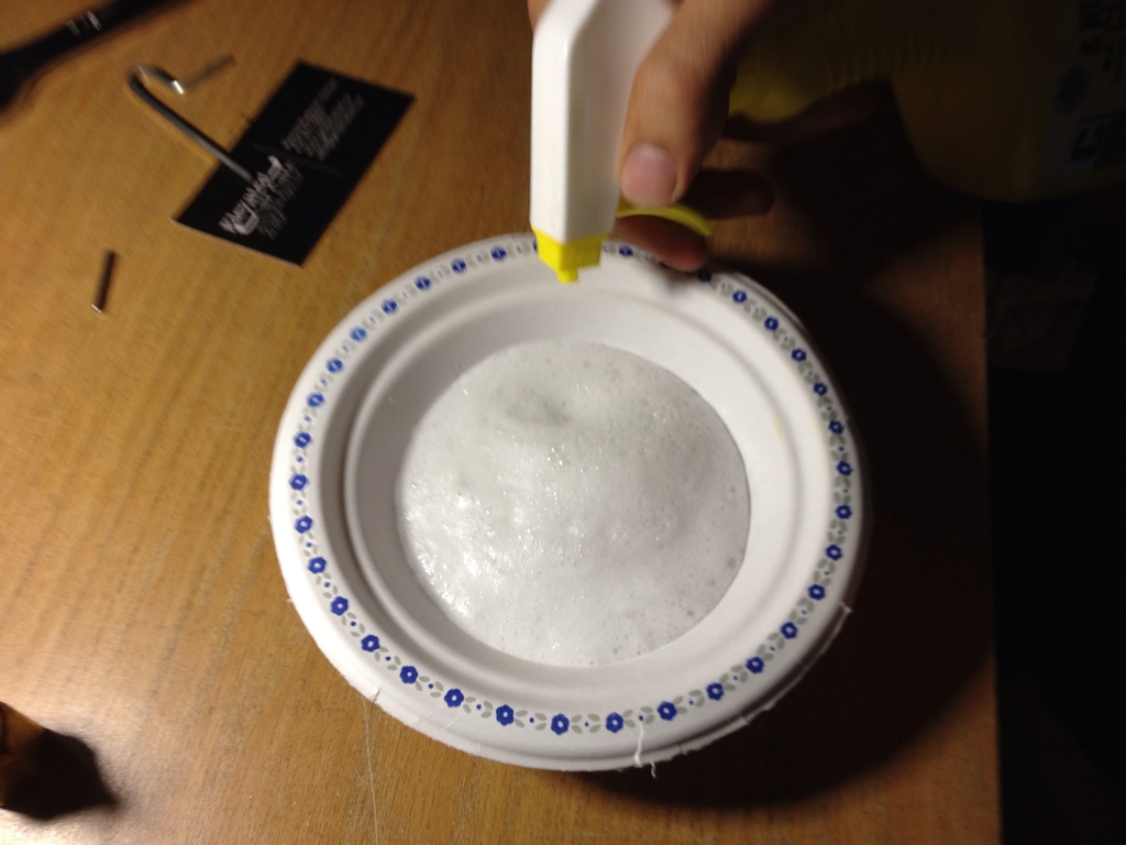

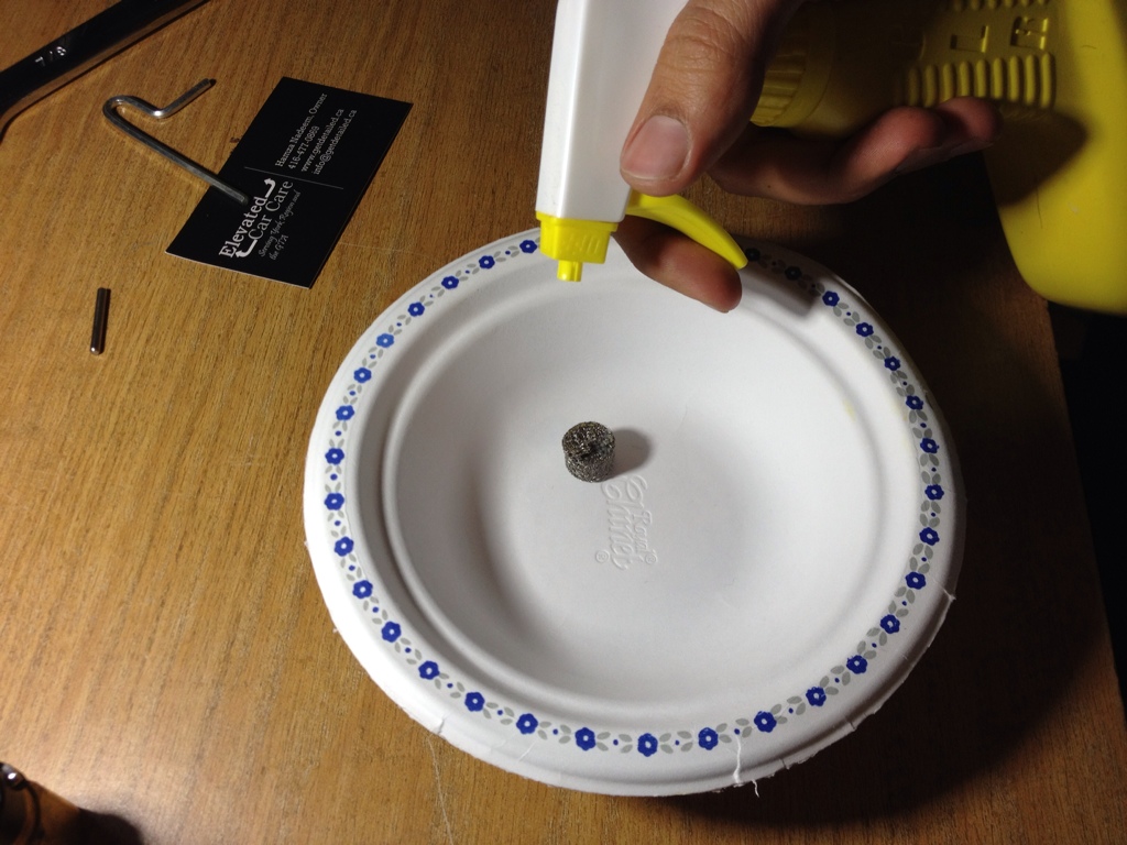

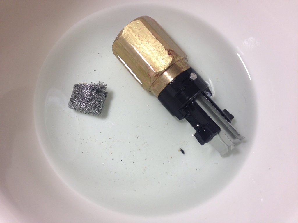

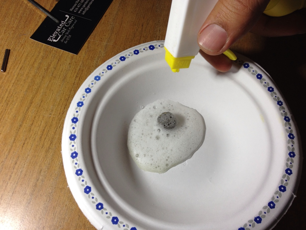

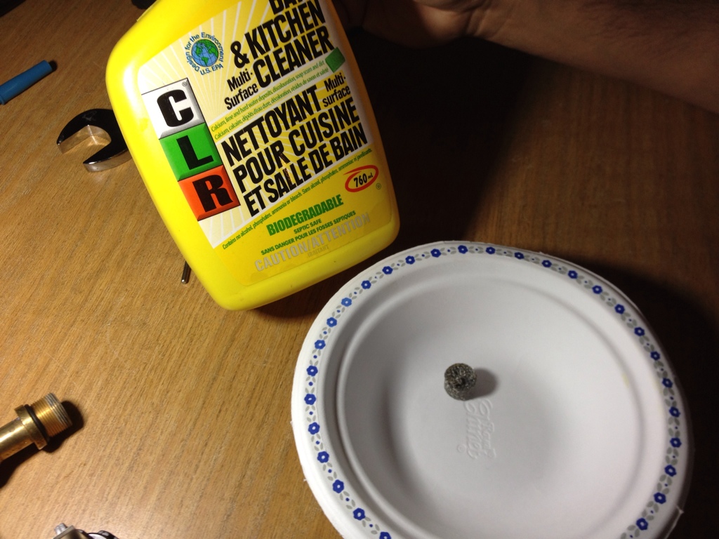

Next put that piece inside disposable bowl, if you have a plastic one it's way better as I found out that CLR eats away at these things so I
changed it
Make sure you coat everything

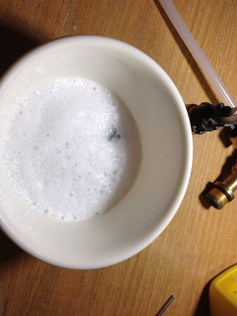

Here I changed the bowl
After 12 hours of dewll time
I then ran it under warm water with an old toothbrush to really make sure I got it clean. It's good as new now.
Reassemble in reverse order.

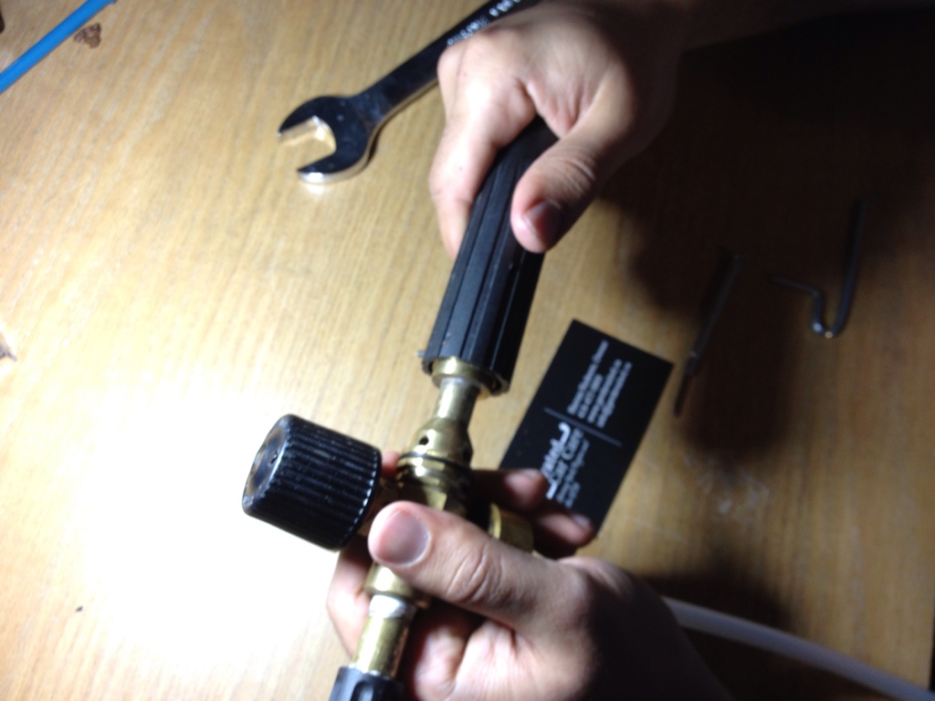

By Hamza7
- Foam Cannon
- A small L key or other small diameter tool
- 7/8th inch spanner or wrench
- Patience
- CLR
- Tooth brush or similar
Pop, it came out
changed it
