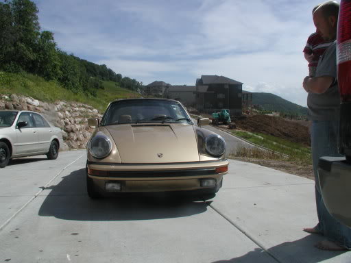

I am a new guy..

Nice car man, where you live?
Old Aug 11, 2009 | 02:58 PM
jason@pmp's Avatar
Joined: Aug 2009
Utah
It has some scratches but its a cool little car. I can't get it to start at the moment though. I don't think I have fuel pressure... I pulled what I thought was the feed line from the fuel distributer (not sure what that is actualy called) and cranked it over and gas slowly spilled out from the distributer side not the line I thought was a feed.. it also only drizzled out didn't have much of any pressure.. any ideas?
If I crank the car over with every thing hooked up it starts for like a tenth of a second then dies..
