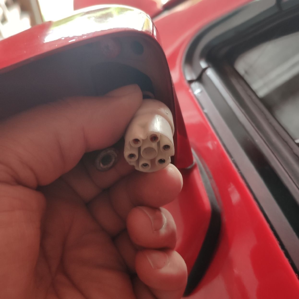

Once these bolts are removed the front of the mirror housing comes away and you will see a barrel connector that allows you to easily disconnect the front of the mirror. Once this is placed aside you can see that the side of the barrel connector still attached to the car is too large to fit through the hole you have in the mirror, and all you have to do is poke the wires out of the barrel connector. I used the end of a pair of needle nose pliers to do it, or you can get a cheap set of "keys" off Amazon/eBay if you search using terms like "Auto Terminals Removal Key Tool Car Pin Extractor", as these only cost around £5.
Once loosened with my needle nose pliers I used something thinner to poke these through the rest of the way
As you can see I've not pulled them through the bolt in this pic, the bolt coming loose was the reason for me doing the disassembly and they came through this easily.
To re-assemble just do in reverse.
