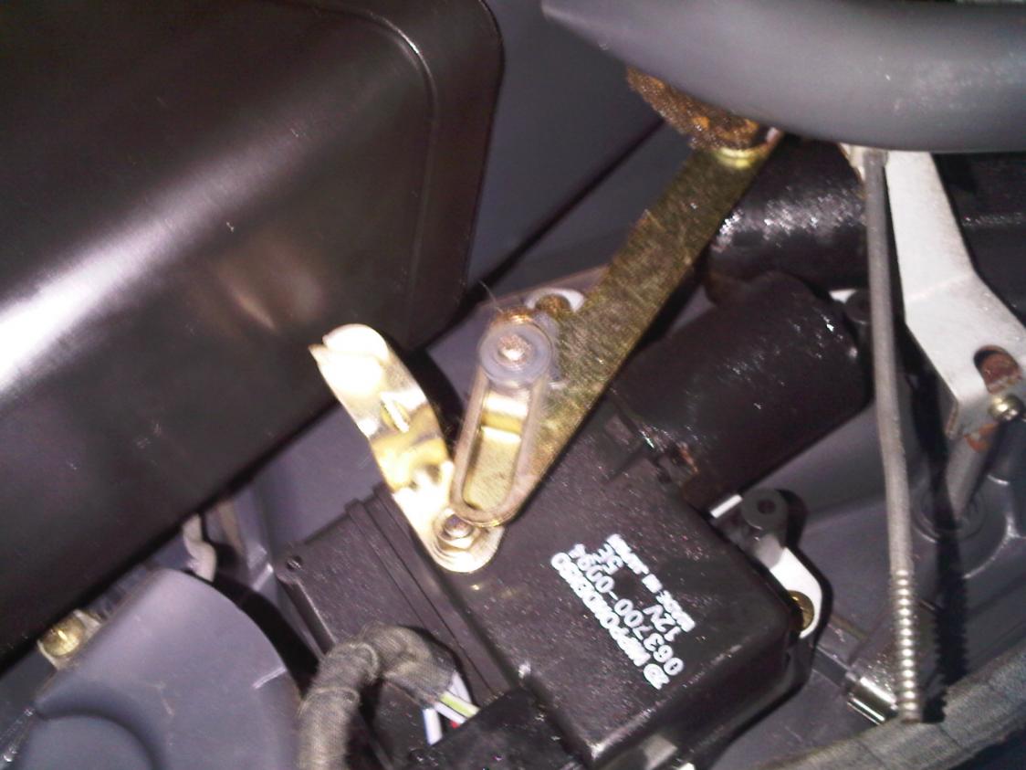

The plastic clip on the blend door is down on the side by the driver's knee (assume left hand drive). There is usually a plastic cover held on by 2 or 3 screws. Remove that cover, and you should see a long metal rod and the end should be seated in a white plastic clip. If you remove the cover and the rod is just dangling there, you will need a new clip and retainer (IIRC about 3 bucks each from porsche). That should take care of the heat issue.

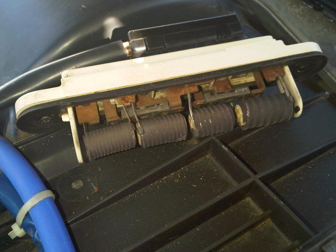

The blower can be due to a gummed up resistor on the blower assembly. Look for a long white plastic piece held to the housing with 2 screws. Might remove that and try cleaning it and see if that doesn't solve the blower issue.

Ok, so I took a look at the car today. First of all I did find that clip broken as you were talking about. I posted a picture of it, I think that is the one. Anyways, where would I get one of those. I know several sites, but I don't have any idea what that part is even called to search for it.
Ok as for the resistor. I also sent a picture. Is that what I'm looking for? It seems OK, but I'm not really sure what to do with it. There is a bit of corrosion on it though. Anything in particular I should be looking for or testing on that? Also where would I get one of those if I choose to just replace it?

Fix the blend door first, and just clean the connectors on the resistor for now. The clip is available from the dealer for about 6 bucks (actually it is a plastic clip, and a metal retainer clip that keeps the rod from popping out).

Ok, I finally tracked down that part and its on its way. I'll hopefully get that in next weekend and clean the resistor and let you know how it goes.

Ok, so I got the clip in and installed. However the clip on the other end of the arm has broken as well. Even so, I get nothing from any part of the heating system. No fan, no duct movement, no heat, nothing. So I am beginning to wonder if perhaps it is the AC computer or bad wiring/ connection/ fuse/ relay to blame. What do you think would be my next step in tracking this down? Is there a way to determine if the computer is still good? And where the heck do I get that other clip. I don't have a dealer anywhere nearby and get most of my parts from pelican, but they don't seems to have one of these. Do you know the part number??
