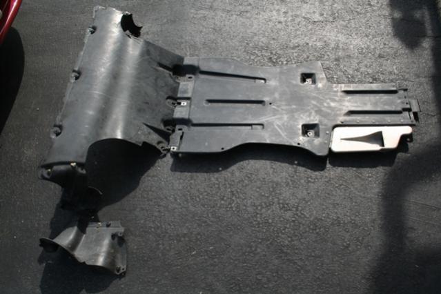

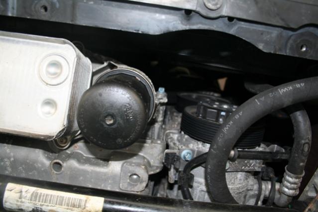

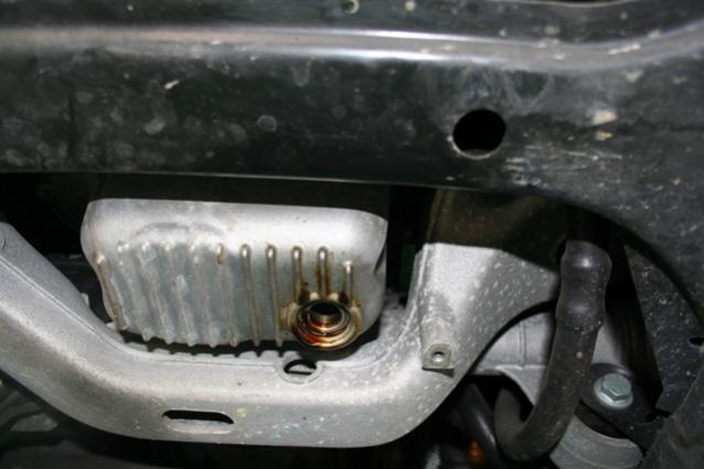

Default Cayenne Oil Change and more
I'd like to do work myself and this is my first Porsche too.
I'm attatching some photos for some who plans to do this the first time.
You need to take out the bottom "shield" then it's like a normal car!
BTW, has any one done the Transfer Box & Differentials oil change? What kind of oil should I use? I don't want to go to the dealer to pay 5 times more than i have to.

Originally Posted by PorscheDoc
I don't know why I missed this, but for the future if anyone does a search on the procedure:
1. Remove the front 2 belly pans on the Cayenne. Held in place by 8mm, 10mm bolts (head size), and 4 phillips screws. Set aside. The front pan covers the front drain plug and the filter, and the rear pan covers the rear drain plug.
2. There are 2 drain plugs, a lower (towards the front of the engine pan) and an upper (towards the rear of the pan). They are 8mm "Torx Plus" bits (This is a fairly new bit, it looks like an Allen, but with convex sides). Remove to drain. The drain plugs use crush seals, so make sure to install new crush seals on the plugs.
3. Remove the filter, which is at the very front of the engine, can't miss it. Black canister, with a paper filter inside. OC128 is the Mahle filter number. Replace filter and rubber O ring on the canister.
4. 8.5-9 quarts of Mobil 1 0w-40 oil to fill. Put in 8.5, start engine, let run for a few minutes. Shut off, let oil drain back to the bottom of the engine for about 2 minutes. Check oil with dipstick with the engine off. Add as necessary.
5. Replace belly pans.
